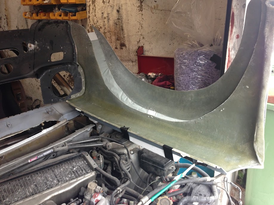

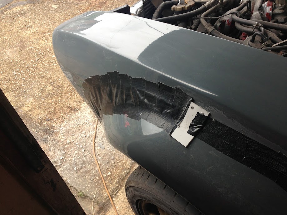

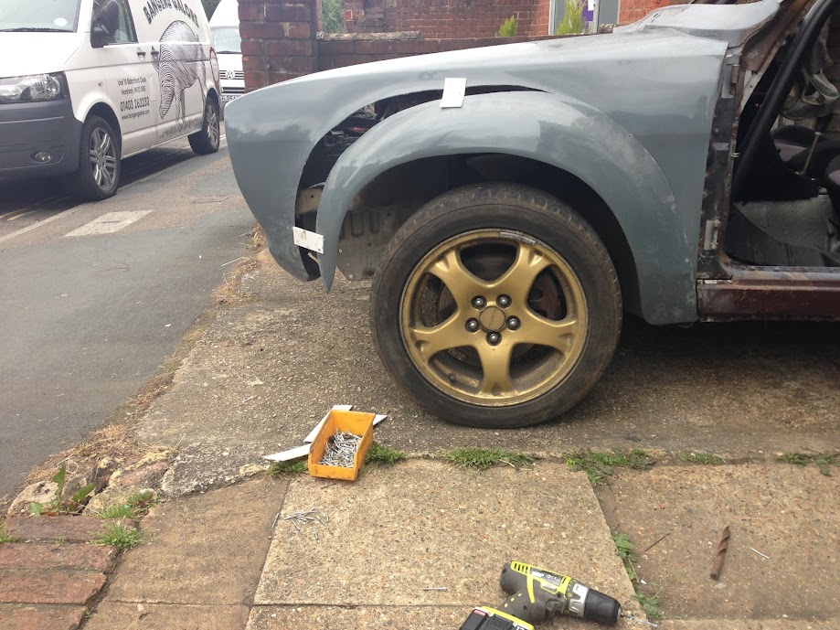

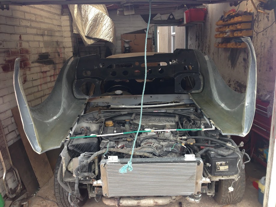

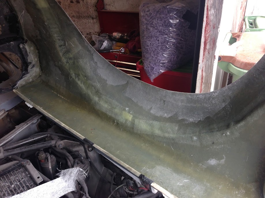

      ok , fathers day ... started off by moving front arches back a bit ,
      i am happy with position now , can allways tweak later.. and dont forget car has to be lower yet
      stuck some duck tape over holes :
      did both sides , then turned front end over
      and it was raining! so had to do it all inside ,
      quick shot of rad setup :

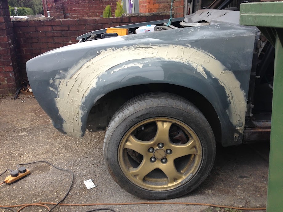

      fibre glassed both arches on , :
      put front end back on car , then removed tape
      then slapped some filler on !
      gave both sides a quick sand
      then took it for a sneaky drive !!!!
      wow its quick !!!

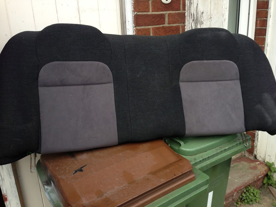

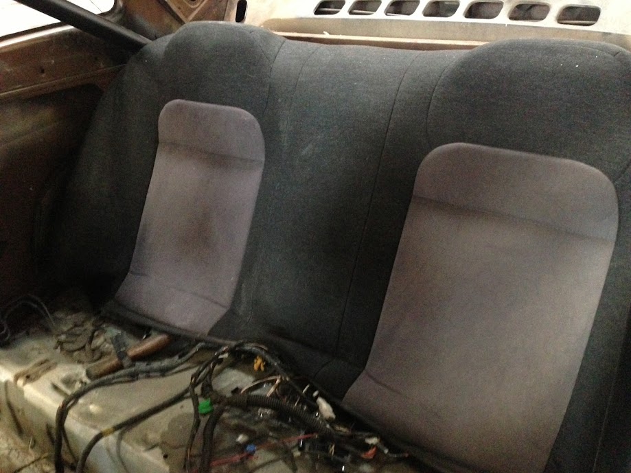

                      so turned my attention to back seat area ,

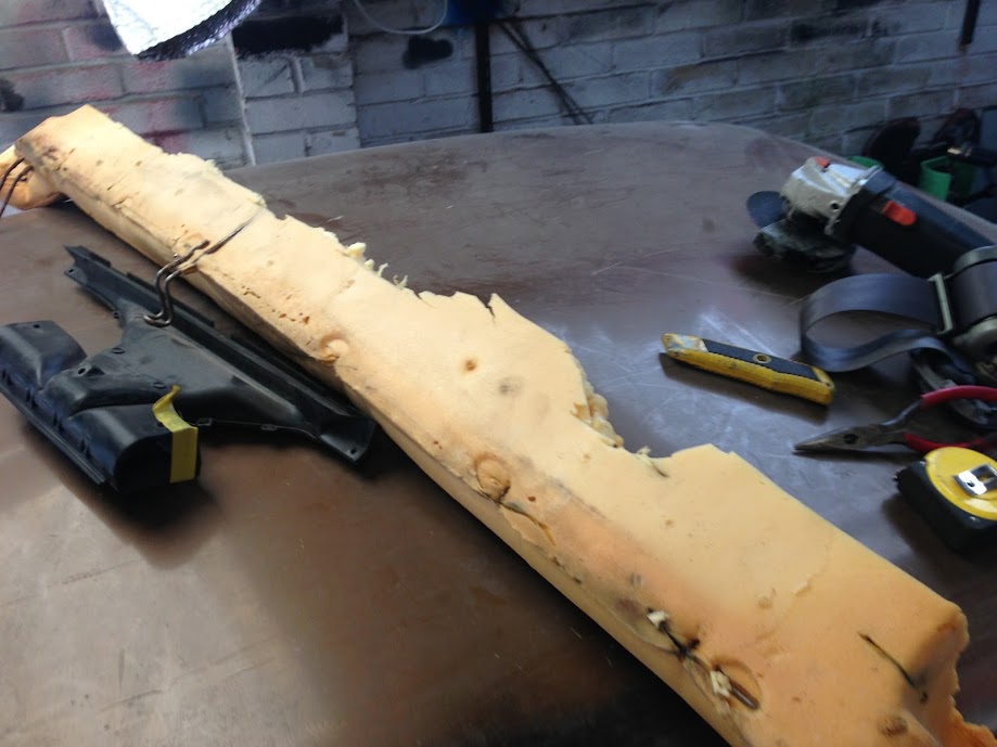

                      cut 4 inchs off the bottom of the subaru back seat foam , after picking /cutting all the clips off.
                      fits allot better now :
                      back sits nice
                      then cut out the wire frame from cut off foam bit, need to weld this back onto the seat so it can mount

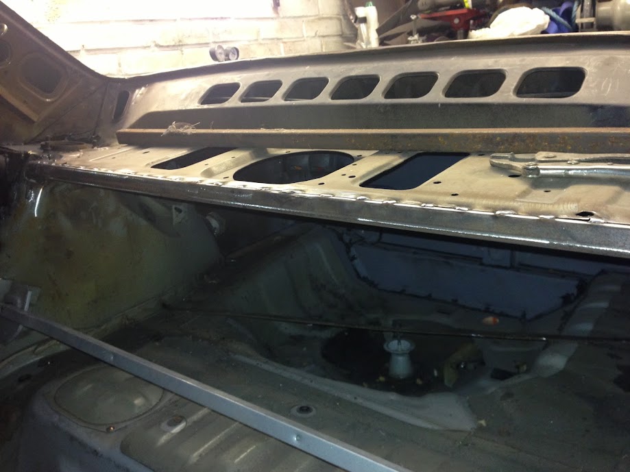

                        • ok , put a new rear seat stiffener in , 25x25x3 box , should do ok

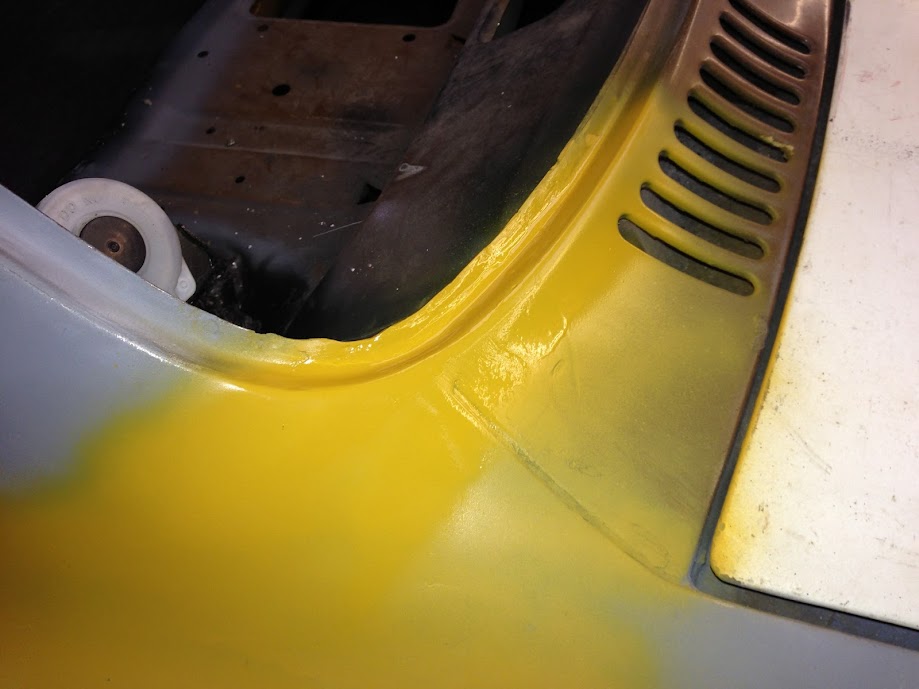

                          jumped to front of car for a second ,and just tacked a bit of metal on

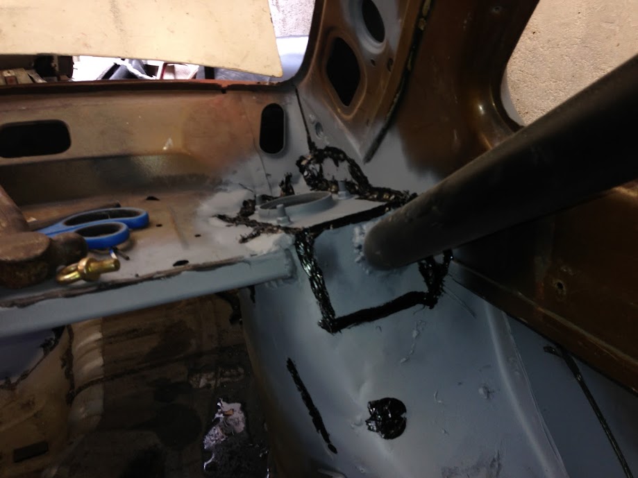

                          back to rear of car , finished welding up struts / body shell , etch primed and seam sealed.
                          quick photo of my cut down seat ... might need tweaking . will see once its in

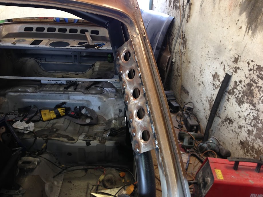

                          welded in cage stiffeners to body ,
                          etch primed and satin black .. done
                          thanks to my friend xxx for sending them to me ,
                          not in photos is all the rear seatbelt points are in and welded.
                          Just doing front ones now and the rear should be done. ( apart from fuel filler neck)

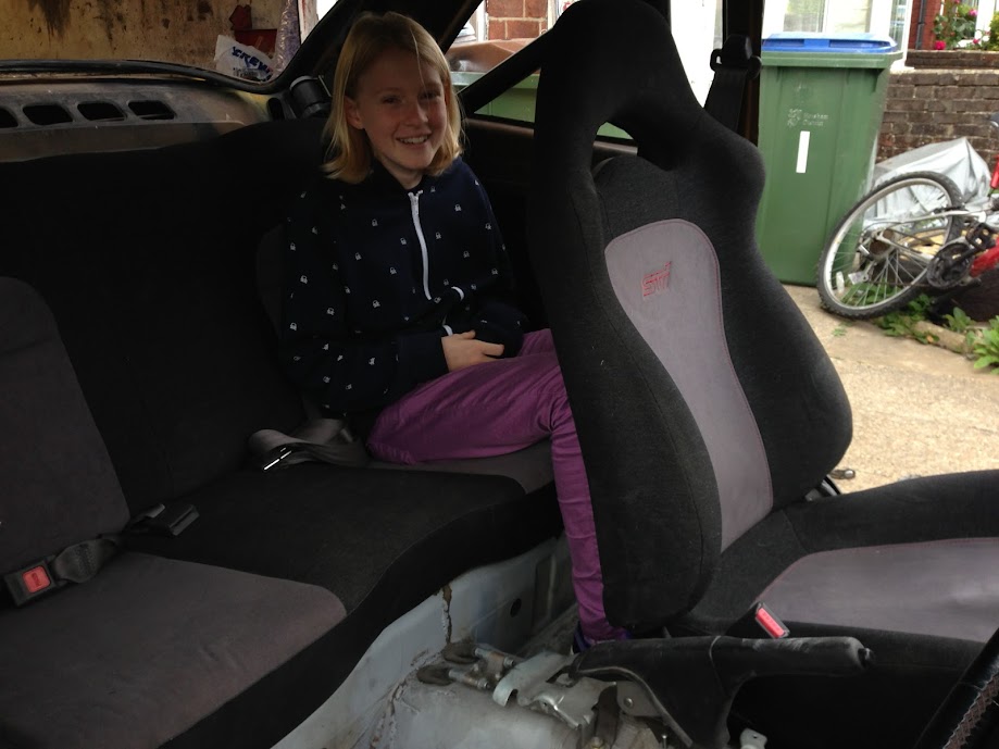

                          • rear seatbelts fitted ,
                            got rear seats fitted , could do with a little adjustment later , but fine for now
                            had to do a little repair on rear window
                            started popping windows in just to see what i had
                            only got one side window seal , and its shot .. so will need to order a new pair
                            quick test fit of a child

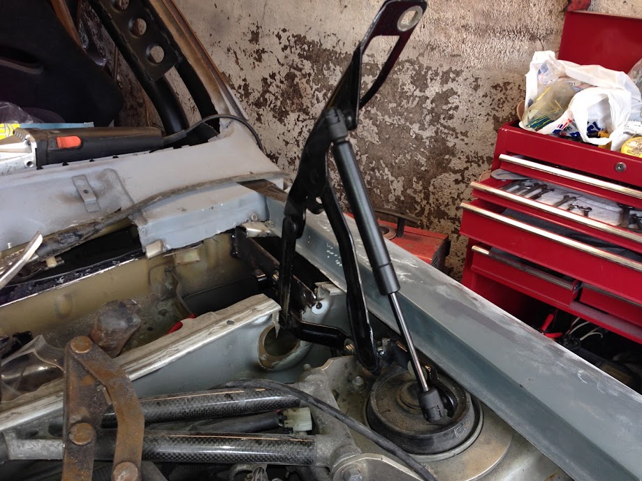

                              bought some audi TT bonnet hinges off ebay , hoping to re-use them instead of the old escort ones .. we shall see ...

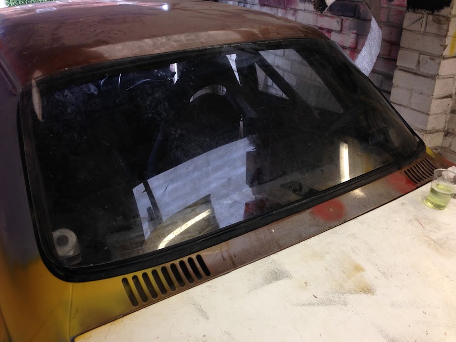

                              also got rear screen in ,
                              rubbers a bit knackered , but will do for now.
                              • got one of the Audi TT hinges mounted ...
                                only tacked in , and needs some tweaks yet , wont know if struts are strong enough to hold bonnet up until i get other side done and bonnet on ! LOL
