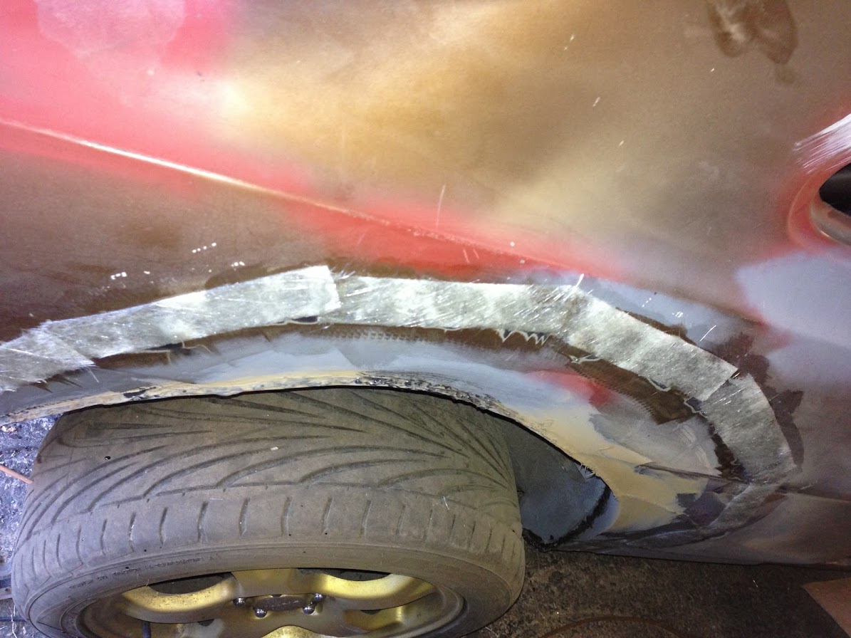

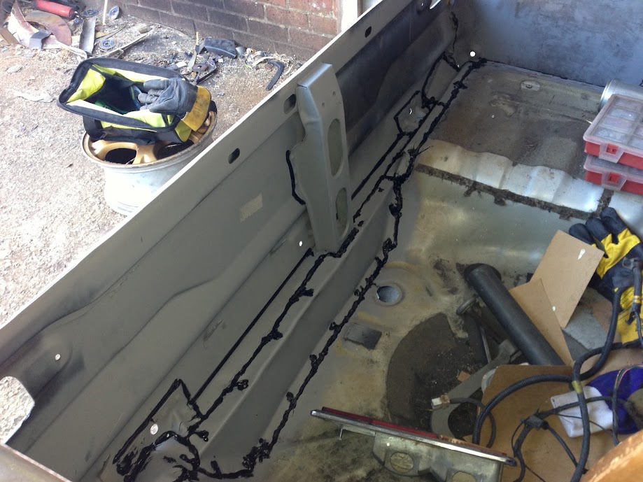

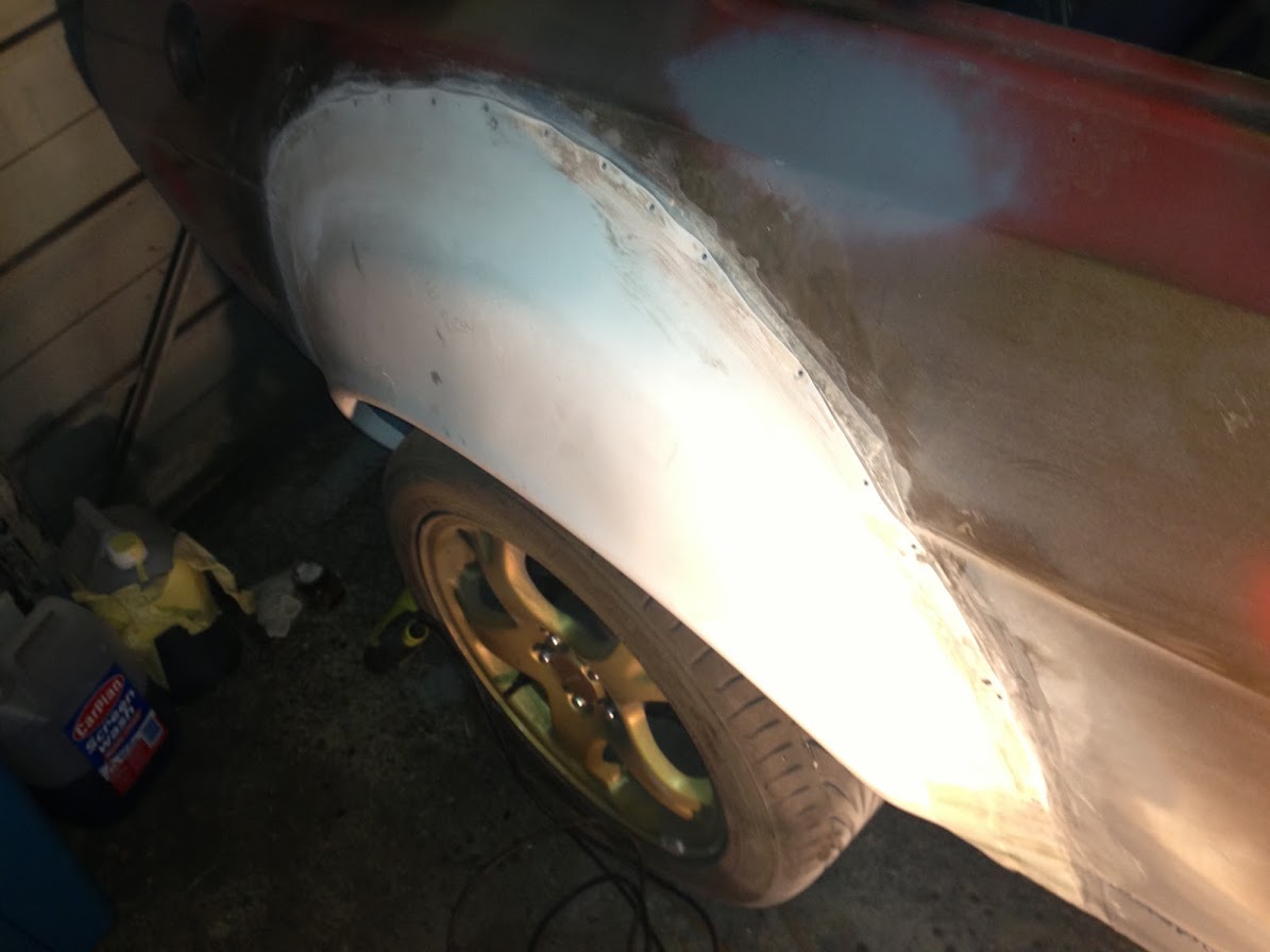

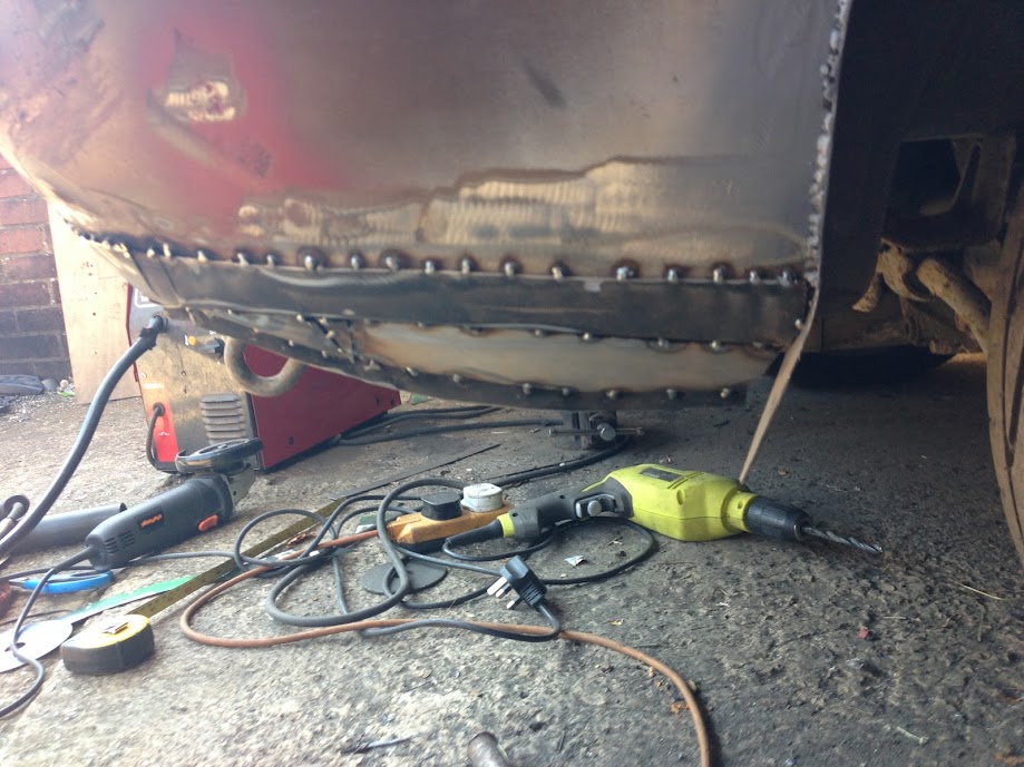

ok seam welded the passenger rear arch tub up , :
trimmed it back
filled in hole
slapped some primer on it , all of this area will be under the bubble arch
one side done ,apart from seam sealer ( ordered aload ! )

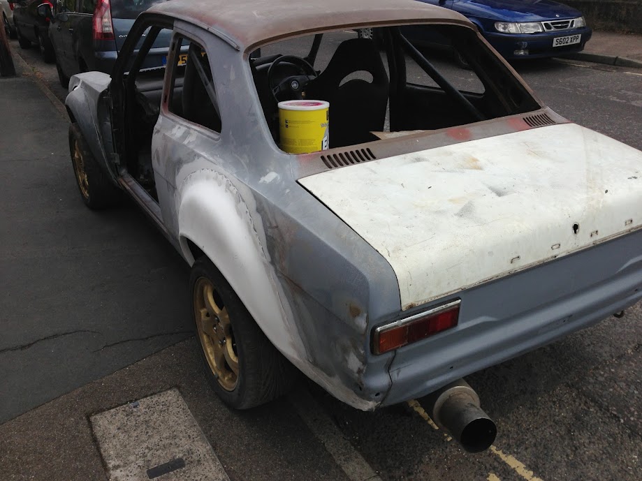

passeenger side went well , and thought lets crack on with drivers side, so turned car around ( dont have enough room to work on both sides
tacked on old part of sill
then cut away escort wing ,

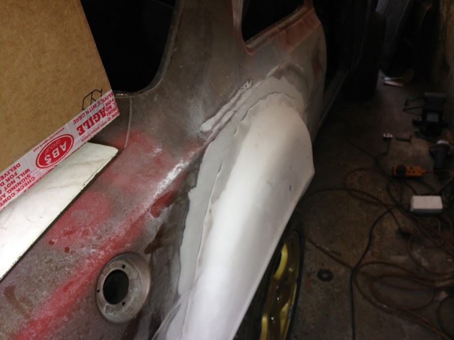

this is the point i found out that the drivers rear arch is not round , and is a funny shape go around the old subaru fuel flap/neck
so it would not be as simple as the other side .. so i called it a day ..

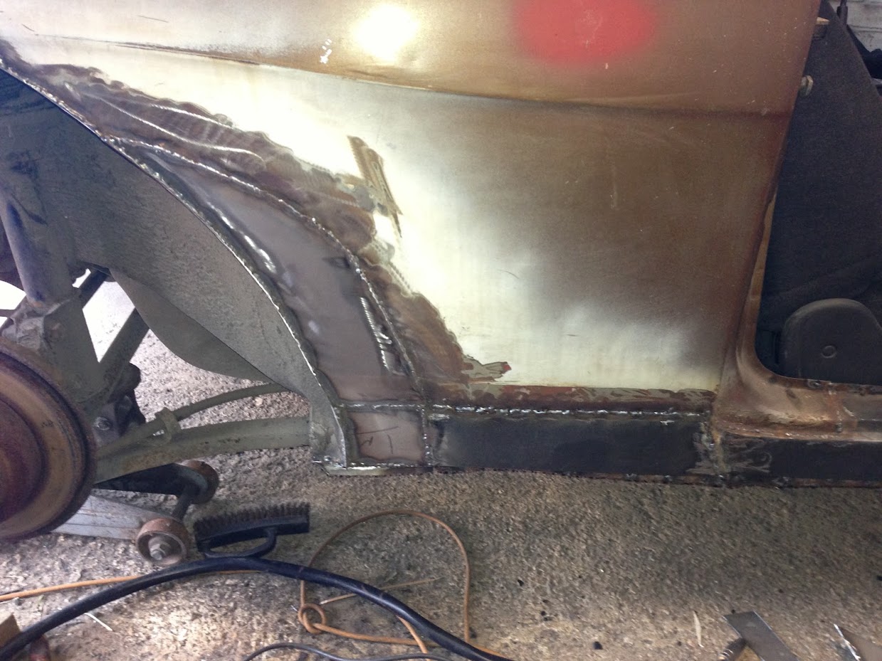

next day , i started by tacking in the tub sheet
hard to see / explain , but i had to add a 2nd peice of metal to the old subaru arch , so it could follow a nice line to match up with tub of arch. , not the nicest , but will be ok, and never seen
all welded up , and ready for primer / sealing

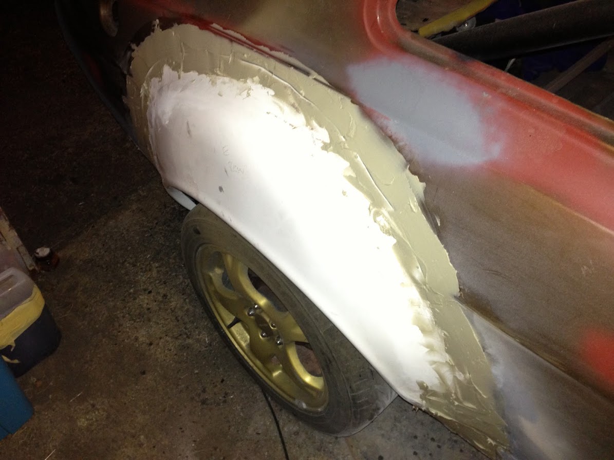

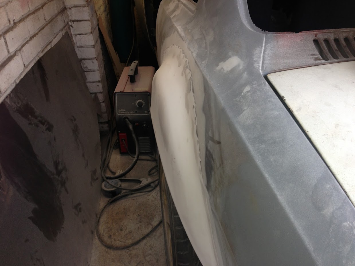

then started to fill in drivers side holes
and thats where i left it sunday afternoon ...best give the neighbours a little quiet ...
so spent allot of time ,with not much to show .. sorry
trimmed it back
filled in hole
