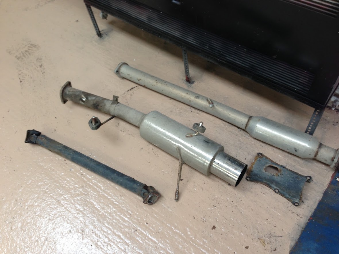

propshaft / exhaust / hand brakes all came off :

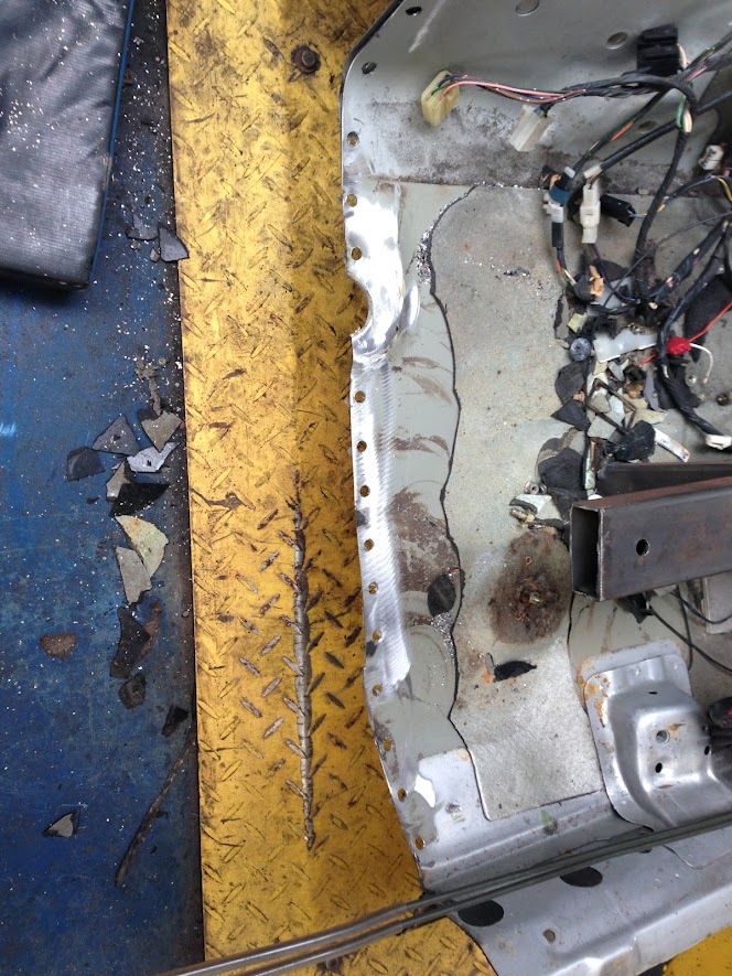

then excess / spot welds drilled out.

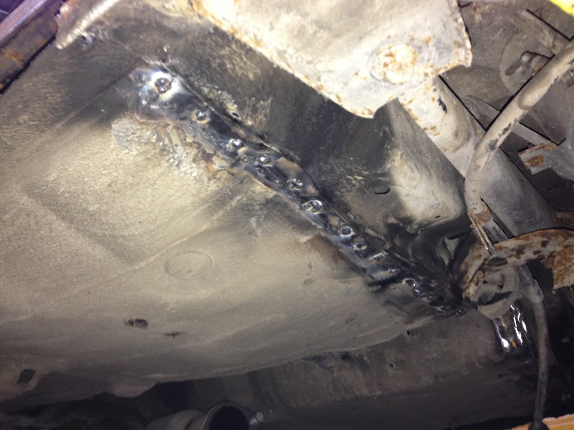

front end part cleaned up , with spot weld holes drilled for me to plug weld
test fit , and my bars bolted up in there new position :
after adding some trianglation bars , to stop car from bending , i seam welded the top , then lifted car and then plug welded underneath

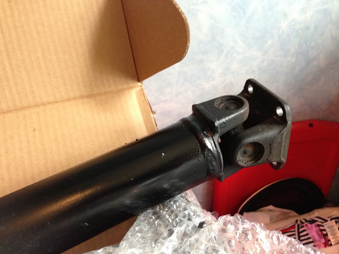

propshaft has been sent to http://www.cpsdrivelink.co.uk , to be shortened.
hopfully they can turn it around soon , would be nice to get mechanics running again.
Matt
phone call from propshaft company at 10.30 this morning ,saying it had arrived , and they had done it !!!!!
took payment, and sending it out today , next day .... really cant argue at that !
should have it all back on car at weekend !!

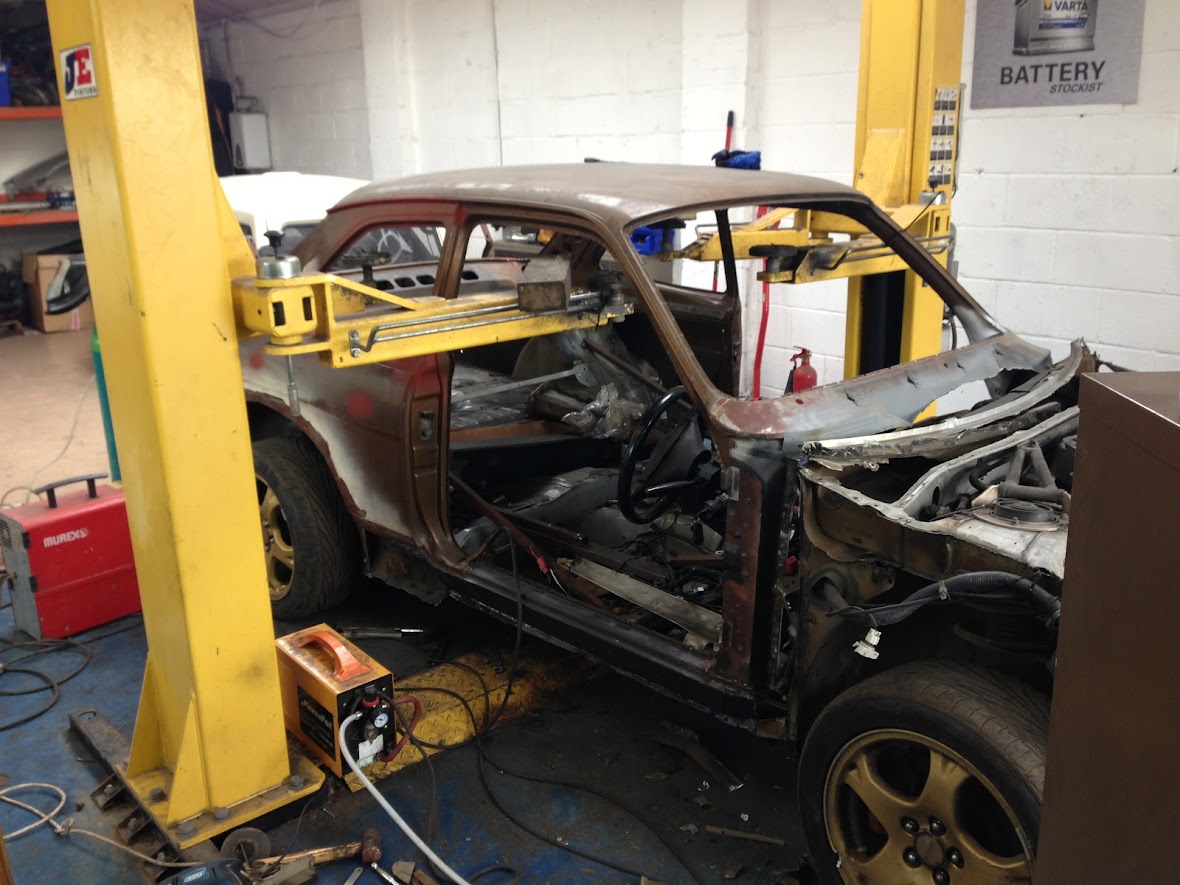

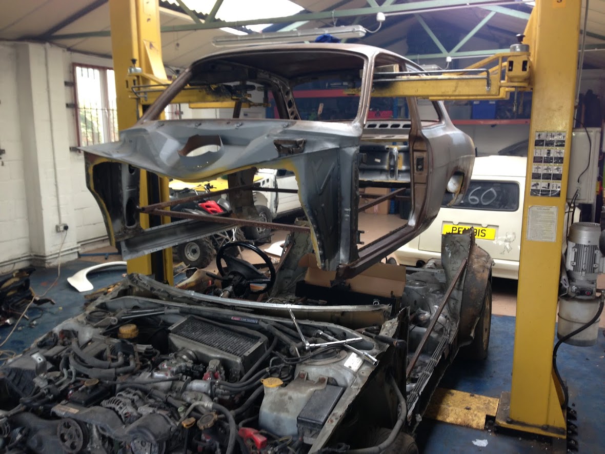

start of the day , we had this :
now it really did not look like it was going to fit , but i was confident ...

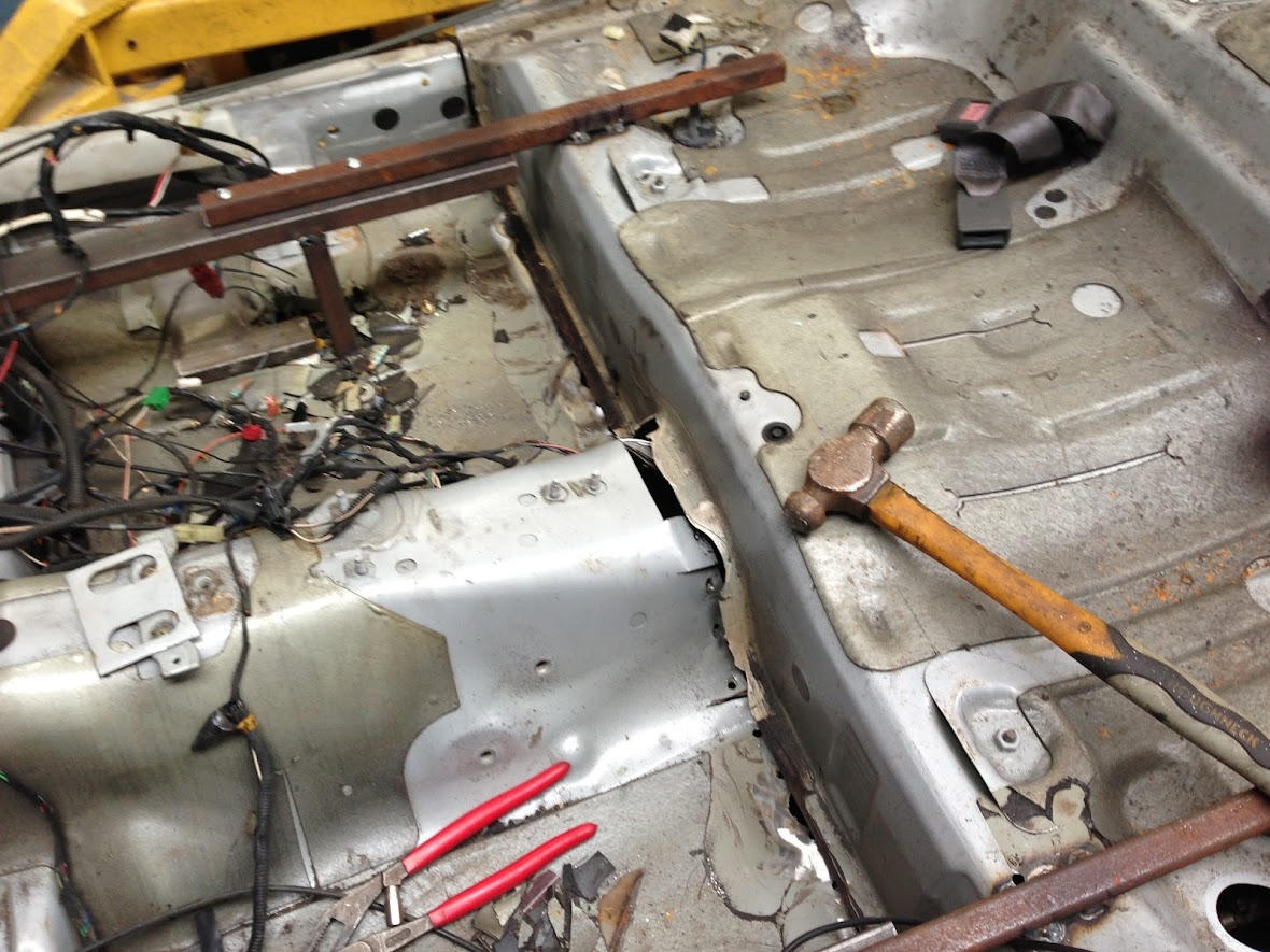

we removed inner sills off the escort , the plan is to run roll cage tube inside the sills , then make new thicker inner sills once its attached to the subaru floor.

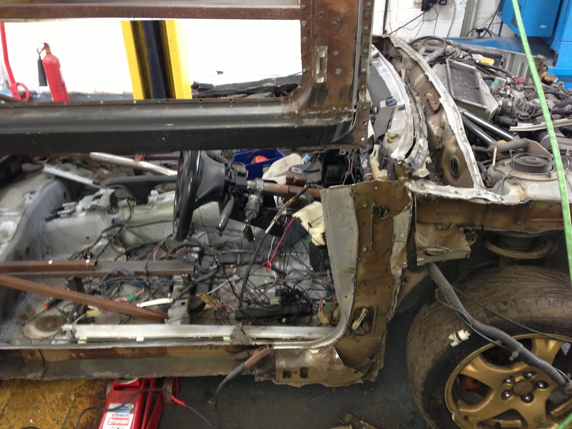

pic showing that all the old door post has to go :

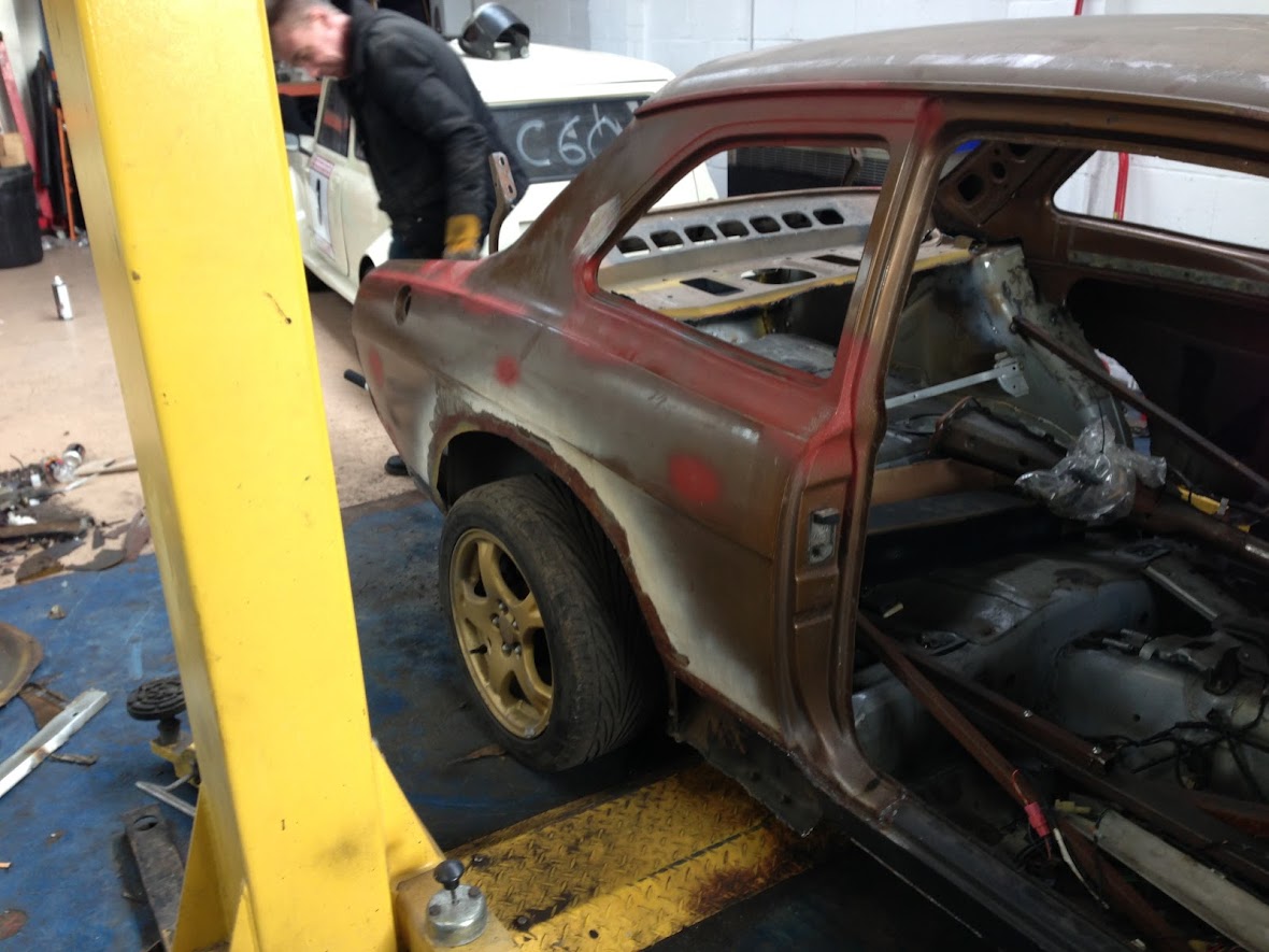

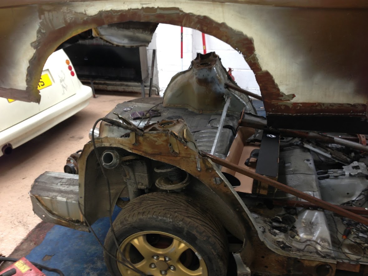

rear arches cut out on escort ( have bubble arches to go on )

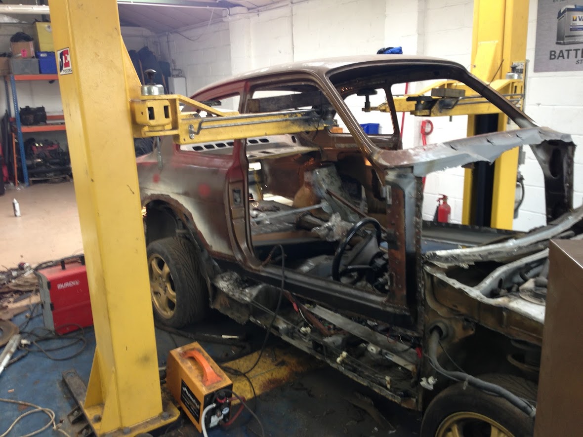

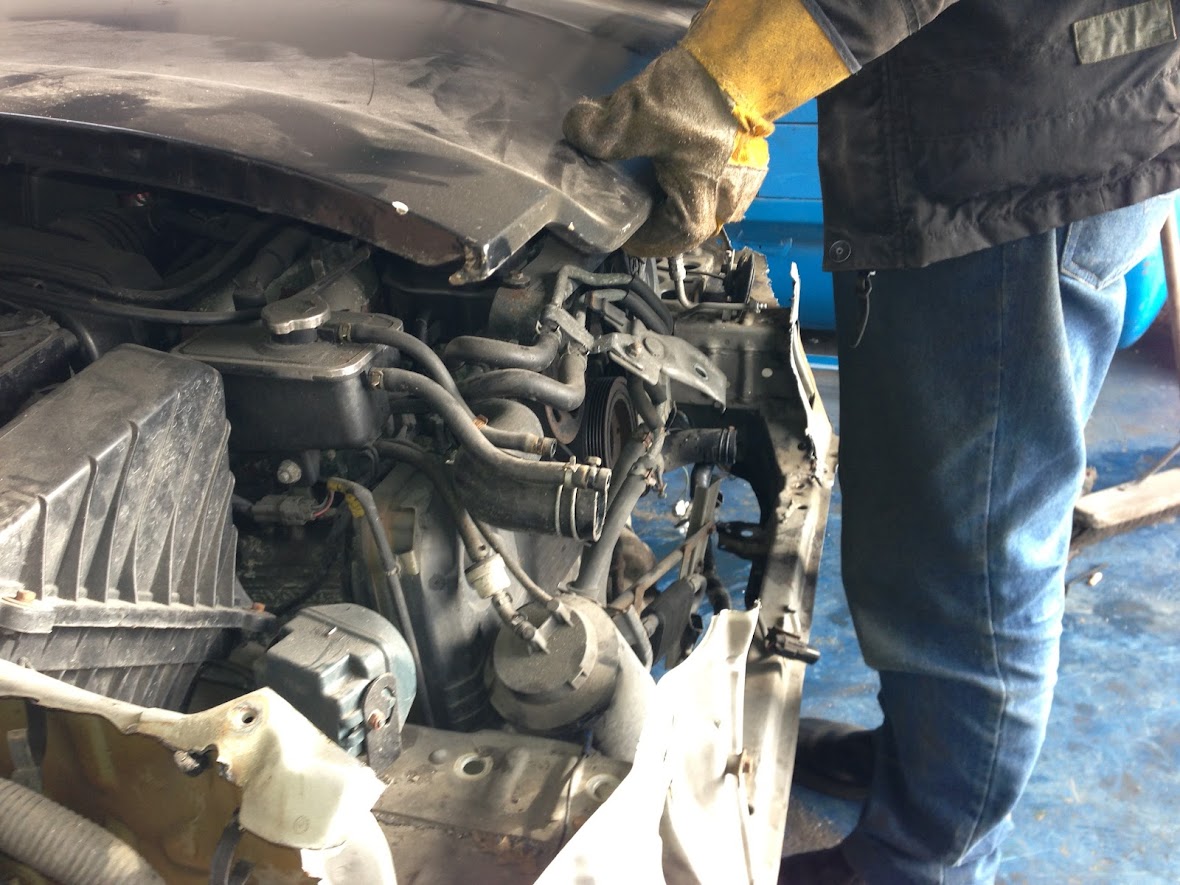

more trimming on subaru , we spent hours cutting metal off ! thank god for jerrys plasma
its now getting lower :

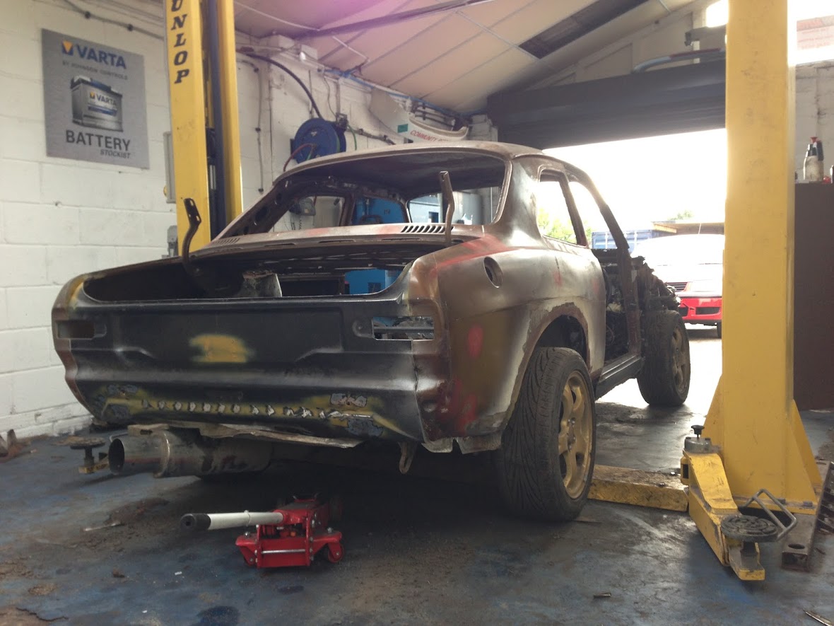

and finally after 6 hours of cutting , it slips on like a glove
bubble arches will work really well i think :
anyway , thats where we left it , its not even tack welded yet , but thats the next stage , confirm position of shell is good , and make car all strong again !
