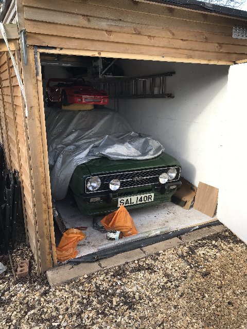

Opened the garage. First time in over 2 years, that’s the view that greeted me.

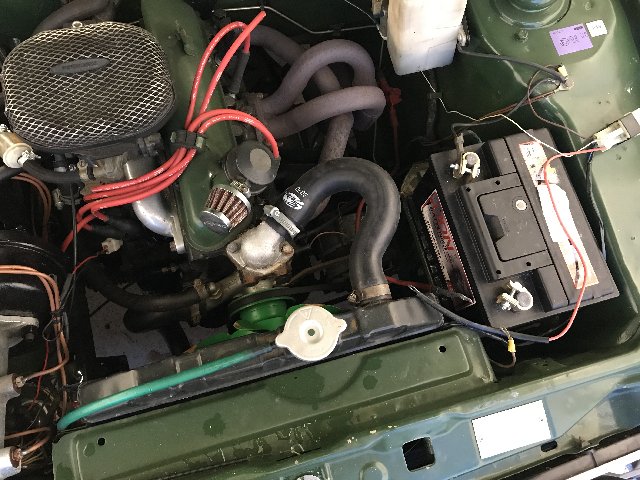

Took a while but started up, and ran ok,
Swapped the radiator pipes for new ones and sorted the spot light wiring as I had it wrong and sorted a new battery out.
It even shot some flames. Haha
Paul....
Originally posted by bigjohnie View Postgood stuff ,but take that lion battery back and swap it for a decent one mate .they are utter dung and will give you trouble

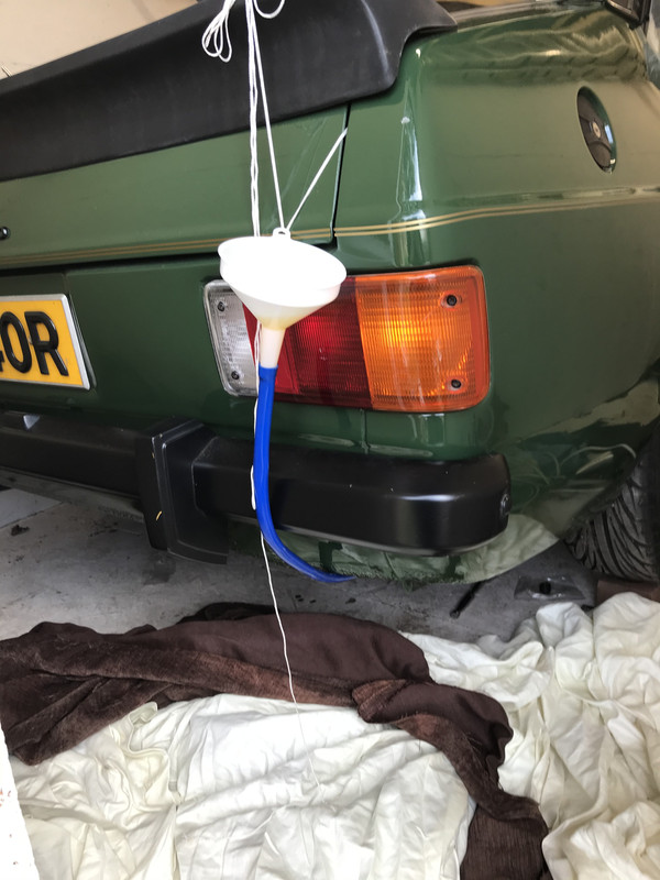

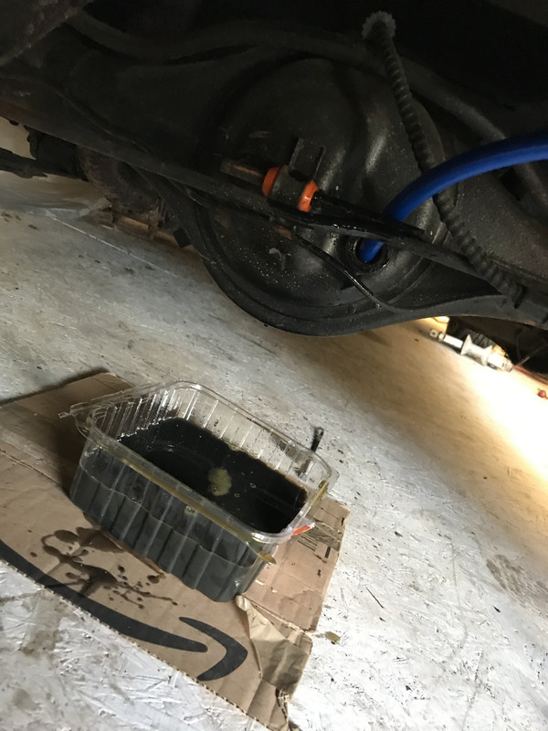

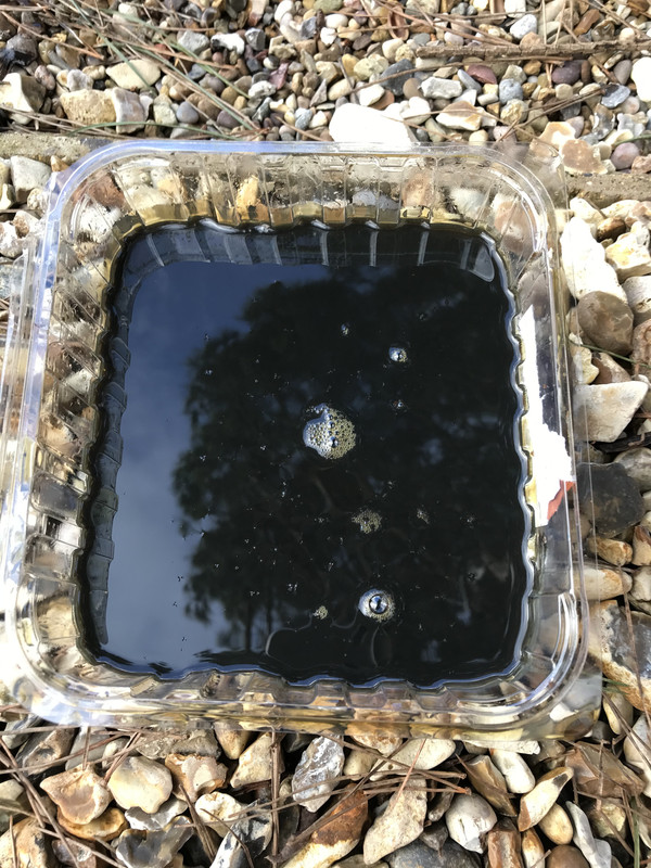

Bought a oil pump thing today and sucked out most of the oil in the diff
Was pretty bad, I’ve never changed it and the car has only done 28000 miles so it’s probably genuine ford oil.
Gravity filled it though to make things easier.

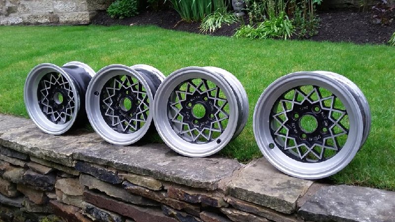

Bought some wheels, as fancied a bit of a change, two are cracked so now on the look out for some replacements.

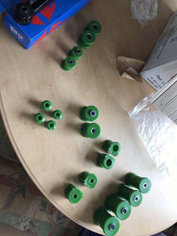

Will re under seal the underside, and paint up the parts as they come off and go back on, Duraflex polybush set, cheap buy actually look the part and should be fine for the use the car gets with me.

Don’t shoot me but Capri laser alloys on an escort
Mexico steels didn’t fit over the new brakes

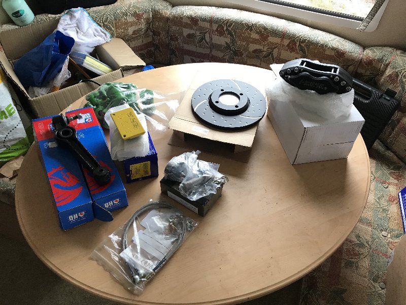

New hispec calipers, yellow stuff pads, grooved discs, new TCA’s track rods, poly bushes, single leafs, new carburettor
Car drivers very well now, like night and day compared to how it was, everything I took off I expect was from 1977
I have a rear disc set up all ready to go on and will order an ATB LSD tooPaul....

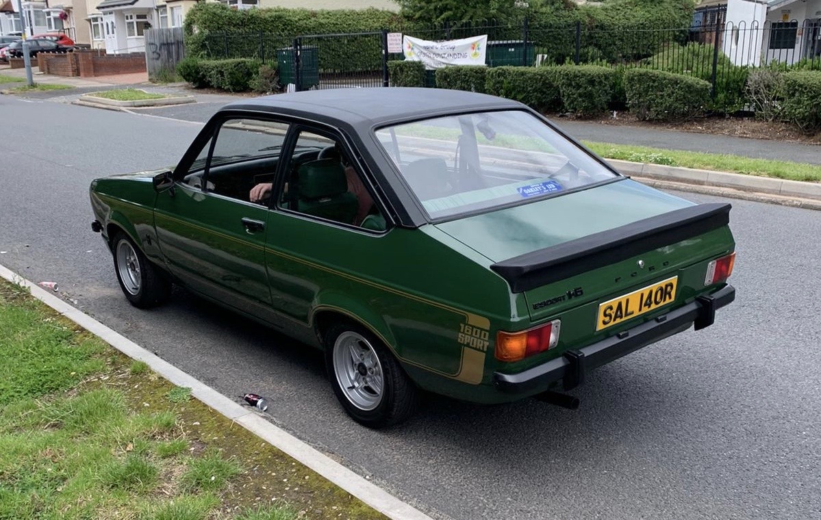

Can't imagine why you chose 'Green' polybushes LOL!
The only thing i'd change is the plates - flat perspex pls. I know raised letters are retro and 'in period' but the car just looks so 'smooth' the lumpy plates just jar with me LOL!
